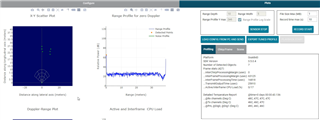

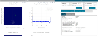

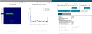

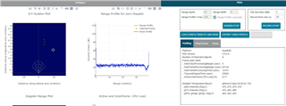

Q1. When moving, the object is detected, but the Rx power of the range profile is not detected. (left picture)
But when stopped, the Rx power of the range profile is detected. (right picture)
Why is the Rx power of the range profile not detected when moving?

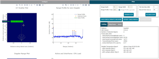

Q2. When moving, It is frequently occur detected objects are separation.
below is when approaching the target. In order, normal(left), starting to separate(middle), separated(right).
How can I prevent that?

  • Hello
    Q1. This is expected behavior. The Range Profile shows detected points given zero doppler.
    Q2. This behavior might be erratic as a result of the spurious change in the doppler bins. For this I would recommend raising the CFAR threshold in the doppler domain. Let me know if you need assistance performing this.

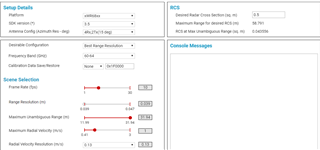

    How did you determine your chirp configuration? Is it taken from existing configuration in the Industrial Toolbox or did you derive it yourself? For this chirp there might be velocity restriction which makes detection of moving objects difficult at far distances.
    Also for CFAR levels you will want to edit the cfarCfg parameter thresholdScale. It is discussed in the mmWave-SDK User Guide on page 27.
    AG
    I used the visualizer to configure the chirp. please refer to the picture and code attached to the first question for details.
