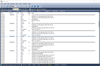

Below is receive and trace info in PCAN-View.
It occur stuff error and form error.
Any advice on why get this errors?
Thanks.

    In code, driver error show after sending a certain amount of messages. but, on trace of PCAN-View, Stuff Error show for the first messages.
    The attached file is the trace log of PCAN-View.

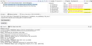

    To remove the risk that something did not get migrated over properly, could you try the Object Data Over CAN demo from the mmWave Automotive Toolbox? It is labeled as a demo for the 16xx devices, but I believe that it should function properly on your 68xx device.
    Alec
  • Thank you for reply,
    I'm trying to run the Object Data Over CAN demo on IWR6843ISK, but I got open configuration failed error.
    But I solved my problem. I changed the data bit rate from 5 Mbit/s to 4 Mbit/s, and it works well.

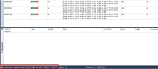

    Be sure that the bit rates in your PCAN tool match the bit rates set in your program, or you will likely see errors due to the mismatch. As a sidenote, please be aware that there is a bit rate limitation due to the CAN transceiver(TCAN1042) used on the mmwaveICBoost device. You can find the part number listed in our data sheet and refer to the TCAN's data sheet to be certain, but I believe 5 Mb/s is the maximum for this transceiver. The transceiver is also an easy part to switch out if/when you design your own board in order to best meet your criteria.
    Alec
    I obviously matched the bit rate settings of the PCAN tool and my program. (Normal is 1Mbit/s, Data is 5Mbit/s at occur error)
