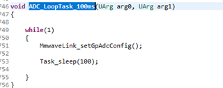

HI,
How to read the value of GPADC?
  • Thank you, let me verify
  • hello,How do I periodically read the GPADC value
  • periodically call the config function
  • hi,
       I created a task with a 100ms cycle and called the MmwaveLink_setGpAdcConfig() function periodically, but the DSS core will enter abort() during simulation.
  • You can check the execution time, and then  try lower task priority and longer function call period.
    Thanks.

    void ADC_LoopTask_100ms(UArg arg0, UArg arg1)
        while(1)
            MmwaveLink_setGpAdcConfig();
            Task_sleep(100);

        Task_Params_init(&taskParams);
        taskParams.priority = 3;
        taskParams.stackSize = 1024;
        Task_create(ADC_LoopTask_100ms, &taskParams, NULL);

    I'm sorry, I don‘t’ know where is the problem
  • Is there an example of reading GPADC periodically?
  • We don't recommend adding an extra task to read GPADC data,
    Make sure BSS is not chirping when you call MmwaveLink_setGpAdcConfig(),  for example read it  with interval of a certain amount frames.
