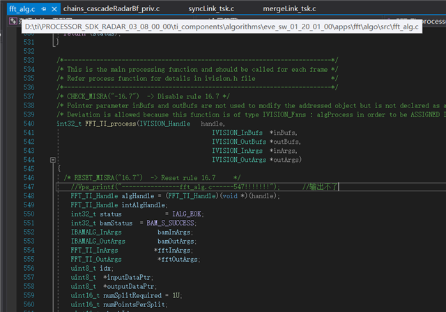

Customers can use vps_printf to print through uart under vision sdk, but they cannot print under ti component files. Do you need additional settings? Does it need additional configuration?
How to enable Vps_printf in ti_components?
Which component under /ti_components are you trying to enable Vps_printf()?
First, you have to be able to rebuild the component. Second, you have to be able to resolve the dependency to include Vps_printf().
