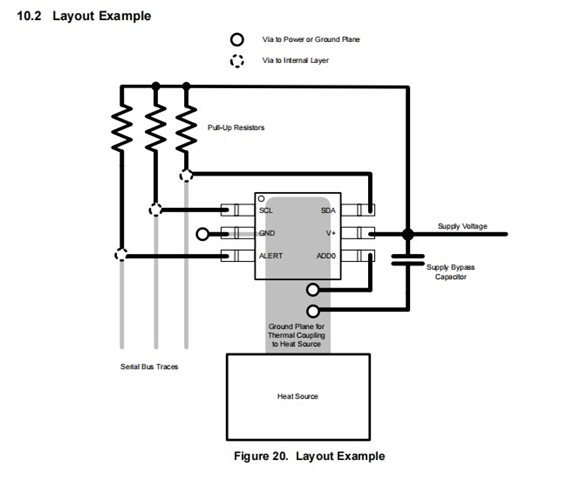

From this picture, it seems GND is connected with heat source. so does it mean the ground will influence the result? what should be paid attention to? thank you!

Hi Yuan,
If you want to measure temperature of 'Heat Source,' you can use metal fill for thermal transfer. If that's not the application, please disregard!
