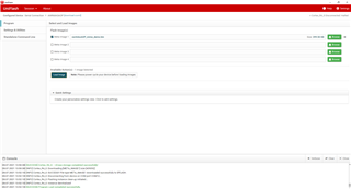

  • As you can see in screenshot of uniflash page, we can programming the flash. We programming the QSPI flash and we get "Program Load Complated Succesfully" message. And we tried what did u ask. We investigate clk and data pins of qspi flash via oscilloscope. We see clear clock and data package. After programming the flash, we change the SOP configurations and reset chip for functional mode. And when we change the SOP mode for funtional mode: 101 and reset the chip, it run into error, pull down the NERROR_OUT pin and blink the led. After taking functional mode and reset chip, it run into error and we cannot observe clock on qspi flash CLK pin.
    In all these steps the problems are still exist and we could not measure 1.4V on 1p4V_SYNTH pin, and why our chip runs into error when we get functional mode and reset it. And we cannot collect any data, we cannot observe anything via MSS_Logger pin on mmWave Studio tool by TI.

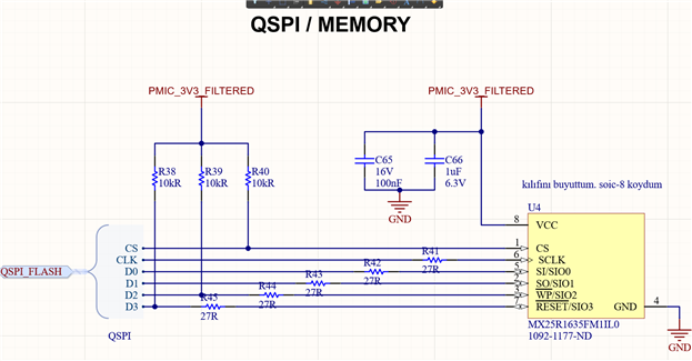

    We have already checked it. Actually when we design this board we have examined the IWR6843AOPEVM module documents and design files.
    TI used MX25R1635FZUIH0 model flash. And we used MX25R1635FM1IL0. They are similar, just our flash have soic-8 package.
    And we watched pins of flash with oscilloscope. As you said, when we writing, it uses single SPI mode. And we see approximately 80MHz CLK signal on 6th pin of flash when we writing. These are OK. After that, we get chip SOP:101 (functional) mode and reset chip. Meanwhile we watched flash clock again and we see clock packages and 80MHz signal again. We can say that, chip starts normally, and it passes some initialize steps to send flash CLK. Chip starts to communicate with flash first, as you can see there is 80MHz clock, but communication is closed after chip run into error.
    But maybe we should focus, why synthesizer  LDO is not working when PLL is working? We see 1.4V on 1p4V_APLL pin but cannot see 1.4V on 1p4V_SYNTH pin. What do you think about it?
    You can look our flash scheme and oscilloscope screenshot when we start chip in functional mode.
    So, we think the problem is not coming from flash.
    What else do you think this error could be caused by?
    Thanks...
    Taha.

  • Hello Taha,
    We have seen problems with MX25R1635FM1IL0 flashes in past, Please see the post below.
    https://e2e.ti.com/support/sensors-group/sensors/f/sensors-forum/804147/ccs-iwr6843-custom-pcb-will-not-load-programs/2976302#2976302
    Please try to use the same flash that is present in the reference design MX25R1635FZUIH0.
    Also, 1p4V_APLL would be powered up by the Bootrom finishes the loading, However 1p4V_SYNTH is used for the powering up the RF section. This would be enabled only after the RF INIT APIs are being executed by the Master system application code.
    In this case before Flash code is being loaded into MSS memory, there is an error detected (Possibly flash reading did not happen successfully),  If there is error in reading the flash code then NERROR would be asserted. All these signature points to incompatibility of the flash device. Please replace the flash with the reference design flash.
