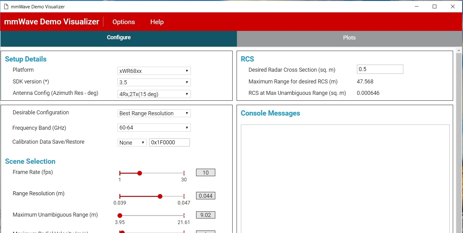

  • Hello Vaibhav ,
    about the demo we use is "mmWave Demo Visualizer" wich is the out of the box demo for mmWave EVM (see attach the picture of the config tab of the demo).
    We already have the meaning of TLV but what i would know is when the EVM emit such mesure (for example, an object is detected when the EVM detect a peak in the radar signal).
    for the guides of uses I searched on everything I found (dyoxigen, resource explorer) and datasheet of all kinds find through the different topic e2e or on the TI page of the product the document "mmw Demo Data Structure v0.1" is very clear but it is not applicable for SDK 3.5 .
    thanks for your help and have a nice day.
