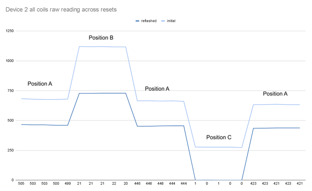

As the title suggests, I'm experiencing a drift over time in the raw values collected by my LDC1614 sensor. In the test, I held the target at position A, then moved to position B, back to position A, position C, position A. These are fixed positions for the purpose of this test. The test duration was about two minutes from the first reading to the last, and then the firmware was flashed, and the test was repeated. The vertical axis is the raw sensor value, subtracting the minimum from the range.
As the graph shows, there's a relatively significant change in the raw values read from the same position over a two minute period. There's also a significant change in raw values read between firmware flashes.
Is this normal activity? It's making it challenging to measure real-world distance to target, as our calibration values seem to lose meaning over time and between flashes/restarts. Could it be an issue with our reference oscillator?

  • The position accuracy is quite repeatable. I've attached an image. A small carabiner is at the end of the braided wire and is attached at the intersection points shown in the image. The sensors are fixed to the base of the wire.
    I haven't tried another target, but the wire is 49 strand, so the cross section is nearly uniform. Also the data doesn't show any randomness as it would if the surface of the target was impacting the measurements. The data shows a continuous trend over time.

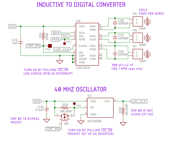

  • It's a custom PCB, 4 layer, running a LDC1614 with three coils. We adhered to EMI reduction techniques in the data sheets. Reference clock is in the screenshot above along with the LDC schematic.

    If a solid target doesn't change the drift/shift you see, then the next step would be to see if the clock drift and/or jitter is the cause.
    It might also be worth confirming the waveform on the sensors are within the suggested frequency and voltage ranges.
