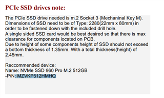

Hi Experts,
My customer is using MMWCAS-DSP-EVM. They are thinking to use commercial products around 2TB.
From the above, the followings look requirements. If we follow these requirements, can we use most commercial products?
- Connector : m.2 connector
- Connection/protocol : PCIe x NVMe
- SSD size : 2280
- SSD thickness : a single-sided card
If you have any other requirements or precautions when selecting an SSD, could you please tell us? Is there another requirement needs to be followed?
(xxTB or more is not supported, a specific manufacturer are incompatible, trouble has been reported, etc.)
If you have any recommendations or proven products, please let us know.
