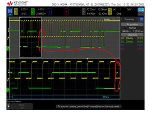

I am looking at I2C communication between TMP1075 and MCU. After ACK , Data line go high and low when clk signal is low. I don't see any functional issue but checking if this normal or need to look in detail in this can cause issues.

I do not believe this is a cause for concern, especially since you are not observing any functional issues. Please let us know if you have any further questions.

Also that data line toggles after ACK signal and before TMP1075 starts sending data. Is this happens as host releases data bus and then TMP1075 takes over ? Just want to know what exactly happens here.

Yes that is correct. This appears to be normal behavior following the ACK signal, as SDA is released and goes high as it returns to its idle state.
