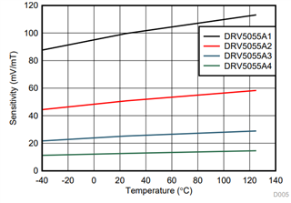

From the curve, the sensitivity of A1 increases with temperature, and the sensitivity of A4 basically does not change. Does this mean that A1 has temperature compensation, but A4 has no temperature compensation?

    1.  All four devices are actually set to the same temperature compensation
    The difference in slope has to do with the sensitivity differences of each.  For example, A1 has a sensitivity of 100 mV/mT, so it needs to drift by 0.12 mT/C.  A4, on the other hand, has a sensitivity of 12.5 mV/mT, and so the output will only vary by 0.014 mT/C.  This compensation is to counter the expected -0.12%/C which is typical to NdFeB magnets.

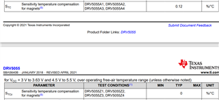

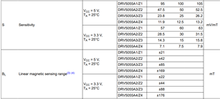

    1. In the table and curve below, A1 and Z1 have the same sensitivity and BL sensing range, but the slopes of the curves are very different. The curve of Z1 is similar to that of A4. In the table, the sensitivity temperature compensation is 0. Does this mean that the Z1 does not have any temperature compensation?
    2. That is, that with Vcc = 3.3 V or Vcc = 5V, 21-22 mT will produce a full scale output voltage. Customer would like to know where did you read this 21~22mT? Is it the change of the ordinate in the curve? If it is, then A4 basically does not change.

    All of the Z1-Z4 package variations are trimmed to have a ~0 mT/C temperature compensation.  A4 does have the 0.12%/C drift, but this represents a small upward trend, where Z4 would be totally flat.  The goal with the zero tempco devices is to allow the customer to account for this in their system as only NdFeB type magnets will drift by this value.  Additionally, if either the magnet or sensor is not exposed to the temperature stress, then the normal temperature compensation will not be correct.  In these conditions it would be recommended to use the Z version of the device.
    For the second question, please refer to the BL specification.  I was citing the A1 version of the device where BL is 21 mT for 5V and 22 mT for 3.3V.  BL can be determined by examining the linear output range of the device and then calculating the required input at the specified voltage required to drive to this maximum value.  So, by adjusting the sensitivity with respect to the supply voltage, the ratio of the output voltage to the full scale voltage should remain relatively constant.
