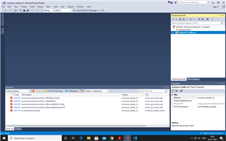

I am trying to make some modifications to the Studio CLI tool for my use-case and am receiving some external symbol resolution errors.
I have looked for these symbols through both the DFP and the studio CLI code and was unable to find them.
Following mentions the steps I have followed in rebuilding the solution. Note : I have not made any modifications to the TI release.
* install Visual studio 2017
* Install mmwaveDFP (version mmwave_dfp_02_02_00_03)
1. Open Visual studio 2017
2. Open the following
C:\ti\mmwave_platform_1_2_1\tools\studio_cli\gui\mmw_cli_tool
mmwave_studio_cli.sln

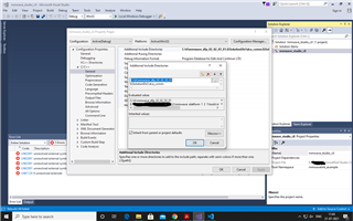

3. Add the path "C:\ti\mmwave_dfp_02_02_00_03" to the path variable MMWAVE_DFP as mentioned in the include directories to the system environment variables.
4. Re-build solution.
