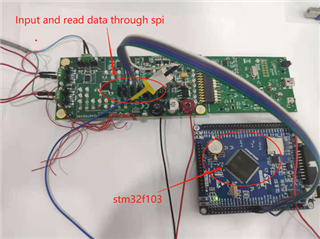

1)I use STM32F103 to send and read data through SPI.
This is a record of the data.

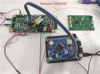

2)
When USB2ANY is removed, all other configurations remain unchanged.
The data was different from the previous comparison. The data collected the second time was not consistent with my expectation, but I could not find the problem

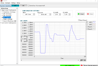

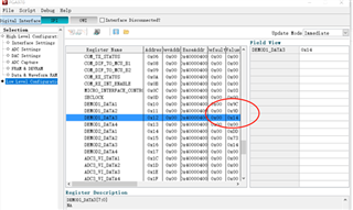

  • 1)The waveforms of MOSI, MISO, SCLK, and CSN are being tested. We will give you a reply after the test is completed.
    2)I am having problems with the PGA970EVM and the PGA970EVM GUI.
