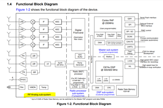

AWR1843BOOST: What is front end
Part Number: AWR1843BOOST
What is front end
I didn't understand when I called the data sheet
  • Hello Yousuke,
    The RF/analog Subsytem which integrates with the programmable MCU or DSP for processing capabilities is referred to as the Front-End. I have highlighted that in the functional block diagram of the device as shown above.
    Ishita
