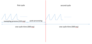

  • Dear Connor,
    Sorry that I didn't explain well.
    The definition of one cycle time includes radar sweeping and post-processing. The schematic diagram is shown below.
    Our application has a longer sweeping time (about 210 ms), which is longer than the maximum WatchDog reset time (167.7 ms).
    In the beginning, my idea is to call the "Watchdog_clear()" at the end of every cycle to clear the WatchDog counter, but the WatchDog reset time is less than our cycle time and this method cannot be used.
    Can we use a "Task" to clear the WatchDog every 50 ms (just an example) to prevent WatchDog reset every time? Is any side effect that we have not considered?
    Jack
  • Jack:
    I would definitely try the example you stated above and see if it works! Over all though it is the responsibility of the application to determine when and how to clear the watchdog timer.
    Connor Desmond
