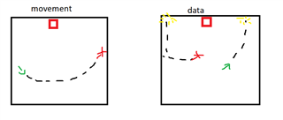

After following instructions in CCS under Software/mmWave Sensors/Industrial Toolbox (4.8.0)/Labs/- Out of Box Demo - / 68xx ODS - Point Cloud Demo,
Pointcloud data seen in the demo visualiser seems to be rotated, displaced and split along the center of the sensor. An image attached shows the behaviour of the detected points in relation to the actual target movement.
Sensor also freezes momentarily when the object is right in front of it, which is about when the data jumps from the right to the left of the sensor.
Any Ideas on a fix? Maybe it has something to do with configurations or in the .bin that was flashed.
Thank you.

  • Sensor orientation is like so IIRC
    So the "teleportation" - when the points flip from the right to the left side - occurs around zero azimuth and zero elevation, facing the board directly.

  • Yes the device was selected as AOP. The pointcloud was represented in 3D in the upper left plot.
    Furthermore, I extracted the live XYZ data with a python TLV parser and the same behaviour was observed.

    thanks! I have some additional information. I observed that the wrong angle calculation appears only in one direction (azimuth or elevation - depending on the orientation of the chip) the angle values of the other direction are correct!
    I'm wondering if this calculation error may occures due to a missing correction of the 180 degree phase shift which is caused by the antenna pattern. Assuming the antenna orientation of the documentation RX1 and RX3 are 180° out of phase with respect to RX2 and RX4. With this orientation this does not effect the azimuth direction but would lead to wrong calculations in elevation. Where exactly in the code is this phase inversion applied to the processing for the corresponding virtual RX channels? To me it looks like the processing for azimuth and elevation is similar.

  • Hi, Charles:
    Since ODS and AOP have different antenna pattern, the fixed worked for AOP may not works for ODS board. You can try following
    compRangeBiasAndRxChanPhase 0.0 1 0 -1 0 -1 0 1 0 1 0 -1 0 -1 0 1 0 1 0 -1 0 -1 0 1 0
    The ODS antenna pattern can be found at:
    https://dev.ti.com/tirex/explore/node?node=AEHINipfikce5tr4bK3rtg__VLyFKFf__LATEST
    The AOP antenna pattern can be found at:
    https://dev.ti.com/tirex/explore/node?node=AGMzFzzFdFllMlyaWeXNlw__VLyFKFf__LATEST
    Zigang
  • Seems to have fixed the issue!
    Will do some more testing in the lab to be sure but data looks good in my home office.
