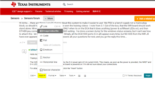

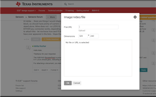

  • Hello Alan,
    Thankyou for your response.
    The IWR1843 BoosterPack is powered by the 5-V power jack (2.5-A current limit). This means, as soon as the power is provided, the NRST and 5-V LEDs should glow, indicating that the board is powered on. I'm still not sure about your connections.
    For attaching a document, you need to click the "Insert" button as shown in the screenshot below. Navigate to "Image/video/file" and then add your word doc.
    Let me know if you need any clarifications here.
    Ishita

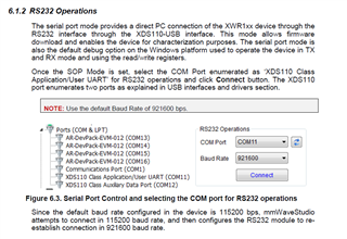

    Can you tell me which interface it means by the RS232 connection? Is it IWR J8, or the other one on the DCA, which appears in windows as a dual RS232.
    This is on the IWR device. Please see a snippet from the mmWave_studio_user_guide.pdf below :
    Hope this gets you started.
