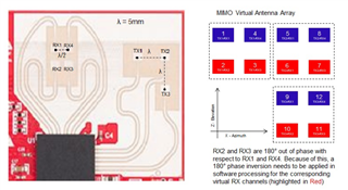

Hi. Referring to the figure attached below (taken from page 40 of https://www.ti.com/lit/ug/swru546d/swru546d.pdf?ts=1626412598310), is the antenna numbering for all RX and TX antennas correct?
- If it is correct, then the ordering of virtual antennas arrays doesn't seem right. For example, the top horizontal row should be 4 (TX1-RX4), 1 (TX1-RX1), 8 (TX2-RX4), 5 (TX2-RX1). Am I missing something here?
- Are any phase or amplitude calibrations required (other than 180 degree phase inversion for RX2 and RX3) for TX/RX antennas (when collecting raw ADC data through DCA1000)?
    Can you please let me know the reasoning why you think so?
    For calibration please refer to "6. 8. Range Bias and Rx Channel Gain/Offset Measurement and Compensation" in mmwave SDK user guide

  • Thanks for the response.
    My reasoning for the order is that the distances between all the virtual antennas should be the same i.e., lambda/2.
    Assume the distance between TX1 and RX1 is 'd'. Then the effective distances for all four pairs (based on the order shown in the figure) will be 'd', 'd-lambda/2', 'd+lambda', and 'd+lambda/2'. As you can see, they are not equally spaced.
    Based on the order I mentioned i.e., 4 (TX1-RX4), 1 (TX1-RX1), 8 (TX2-RX4), 5 (TX2-RX1), the effective distances will be 'd-lambda/2', 'd', 'd+lambda/2', and 'd+lambda'. In this case, all elements have an equal spacing of lambda/2.
    the RX antenna separation of lamda/2 is related to getting maximum FoV. The distance of the object being detected relative to each RX antenna is more relevant than the distance among the RX antennas. The spatial arrangement need to follow the way the RX antennas are named.
