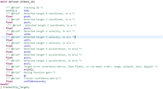

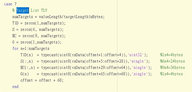

Hello:
I tried to collect the TLV data of the people counting sample program. For the output of XY coordinates (posX, posY), the hex values are 72 13 82 3D and 76 6E 15 3F . How can I convert the corresponding to actual Coordinate value?
