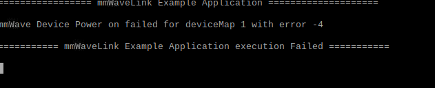

Hello again, I am attempting to execute a port for mmwavelink on Raspberry Pi OS using c++. I have all of my callbacks defined and I am using the mmw_example as a template so when I attempt to execute the port I get the following error message:
I understand the -4 is a radar software/hardware interface error however I am not sure specifically what is causing the error. Is there a way to get more specific debug information concerning this? Again thank you for any assistance as I am in unfamiliar territory.
    Please recheck all your callbacks and return value from those.
    RL_RET_CODE_RADAR_IF_ERROR (-4) can be set due to various cause
    1. rlComIfOpen returns null
    2. rlRegisterInterruptHandler returns -ve
    3. rlRegisterInterruptHandler return -ve
    4. rlComputeCRC returns non-zero
    5. rlComIfWrite and rlComIfRead don't return the same value as bytelength requested.
