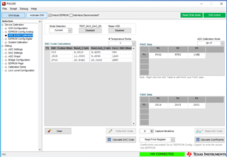

When calibrated:
  • Calibration point #1: -13.5 psi / 4.428 mA / HEX 818 (based to -14.7 psi / 4.0 mA / HEX 766)
  • Calibration point #2: 0 psi / 12 mA / HEX 1800
  • Calibration point #3: 30 psi / 20 mA / HEX 2700
When verified:
  • Calibration point #1: 0.1% accuracy
  • Calibration point #2: up to 4.5% accuracy, I can manually try hex and adjust it to achieve 0.2% later.
  • Calibration point #3: 0.1% accuracy
Please advise, thanks.

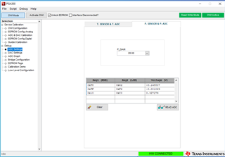

    Can you please show a screenshot of the GUI's calibration page? It would be helpful to see the ADC data during the calibration, and during the verification portion could you also place the PGA300 in reset and read the ADC values from the ADC settings page to see what the raw data shows for each of the calibration points? I would like to make sure that the input is the same in both the calibration and verification stages.

  • Hi Ed,
    It looks like your inputs are very consistent, but according to the DAC calibration window it looks like you are setting the desired output to 9.68mA for the middle pressure point instead of 12mA as you described before. Is there a reason for this change?
    Scott
  • Hi Scott,
    9.68 mA = 4 mA + (20 mA - 4 mA) * (( 0 psi - (-14.7 psi)) / ((30  psi - (-14.7 psi))
    Thanks a lot.
    Ed

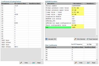

    Since the input is quite consistent at the middle point between the calibration and the verification, it looks like this may be a tricky calibration for the coefficient calculation. Can you also show the coefficients and digital scaling that are calculated and displayed in the digital EEPROM page?
    What is the PADC_gain on the digital EEPROM page? If the value is more than 1, it will be helpful to increase the PGAIN in the analog EEPROM to counter this. It will likely result in a better calibration.
    Scott
  • Hi Scott,
    PADC_gain on the digital EEPROM page was automatically generated as 1. If It needs to be changed for better accuracy, what is the rule to change it?
    Thanks again.
    Ed
  • Hi Ed,
    If it is already set as 1 that is the ideal setting. If it were higher than 1, then it would be useful to set the analog PGAIN to a higher value to avoid the need for additional digital gain.
    Let me look into this a bit more and get back to you later this week.
