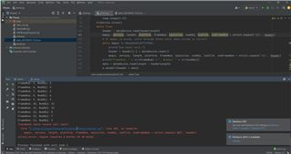

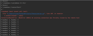

I have downloaded the server.py and client.py files and have ran the code to measure raw x,y,z data. It measures fine and works well but only measures a certain amount of data each time I re run the code.
Example, The first time I run, it would measure say 20-30 lines of code ad stop with this error :
This is one of the errors that it shows but the other error is this:

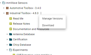

The code can be accessed by downloading the industrial toolbox as seen below:
then locate the file and go into it to find tools --> remote access
