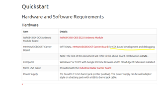

I'm trying to use the DCA1000 connected to an iwr6843isk-ods to debug in CCS v10.
I'm not sure which debug probe to use, but they all give me errors.

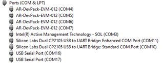

Here's what the COM ports look like with the FTDI cable connected, JTAG cable connected, and IWR6843ISK board connected.
System is Windows 10.
The Silicon Labs is obviously the Radar EVM, 4-7 are the FTDIs and 16-17 is the JTAG cable.
I've tried installing the drivers at ccs_base/emulation/windows/xds2xx_drivers and xds110_drivers on the JTAG COMs, but obviously that didn't work and isn't supposed to as it hard-crashed my computer.
