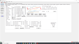

Does AWR1843 only apply to HPF1 when operating in real mode?
I measured with the following configuration and the minimum detection distance did not match the calculated value, so please tell me the cause as well.
 最小
    Can you please share with us a snapshot of the real configuration?
    What object are you trying to detect, what range?
    The snapshot you have provided shows Range = 3.4955m
    Thank you
    Cesar
  • 実際の構成は上記にあります。
    計測範囲は0.3mの地点にアルミの5cm角の棒を立てています。
    I have used google translator:The result is as follows. If this is not correct please let me know if this is not correct.
    The actual configuration is above.
    The measurement range is a 5 cm square aluminum rod standing at a point of 0.3 m.
    Are you trying to detect the cross section of the aluminum rod? Based on our experience this should not be a problem.
    Here is a picture of a measurement we did to detect a wood rod. There was no problems detecting at 0.3m even if it was wood
    As you can see from the Range Profile, if the distance is <0.2m than we will have to take into account the Tx Rx coupling
