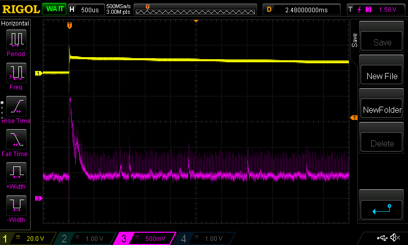

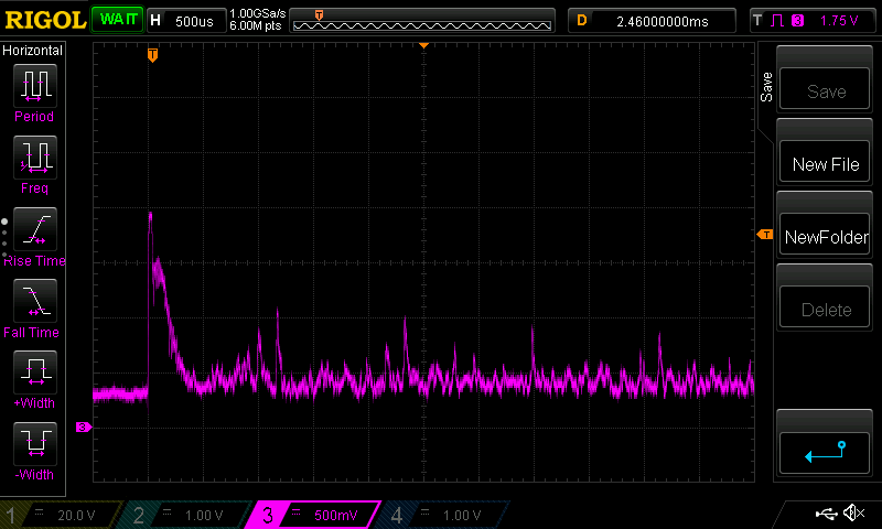

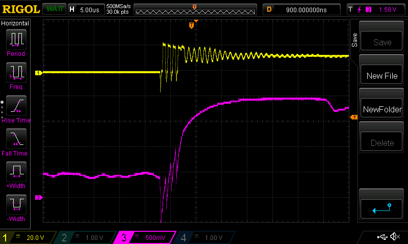

I've got a TUSS4470 on our custom board and connected to a PZT and we're trying to measure fluid level. The container this is attached to currently is metallic. I was wondering if you could take a look at my waveform to see if you can think of an approach to clean up or get a cleaner signal out. I can see 2 bumps which could be used to calculate the fluid level in this case but I'd like to see nice spike echo responses.
Here is my configuration setup:
Add Value
0x10 0x5F
0x11 0x00
0x12 0x1C
0x13 0x02
0x14 0x00
0x16 0x5F
0x17 0x13
0x18 0x54
0x1A 0x04
0x1B 0x02

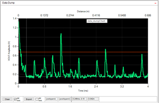

  • Just another note, with the dev kit and using the GUI we we're seeing something more like this which is what we need to achieve with our custom board.
  • Hello Louis,
    Thank you for your question, I agree that the receive signal on the custom board should possess a more prominent spike for the return signal. Did any configuration settings change when switching from the EVM to the custom board?
    Additionally, are the physical testing setups the same between the custom board and TUSS4470 EVM? I ask, because the scale on the first scope shot with the custom board is set to 50us /div, and the EVM GUI has spikes in the ms range. Did you by chance see any return signals that lie outside the horizontal range of the scope? Understanding the tested range between transducer and target can help me to know the expected time of flight for the application.

    The transducer is wired from the board to the container using wires that are around 300mm in length during development. This is similar to the previous testing. However this is much more than the end solution which will be around 35mm.
    Adding the hot glue made the signal worse. I now can't see any second peak.

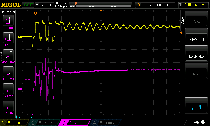

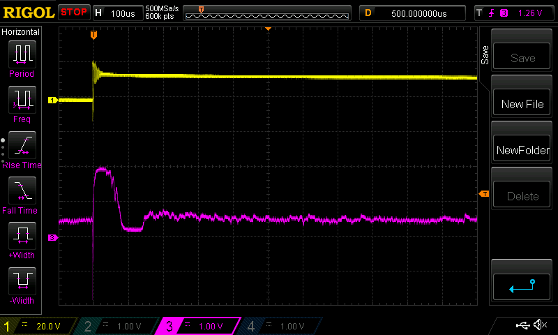

    Something also useful to note, originally I was scoping both the PZT line and the TUSS4470 Vout line. See image below (this now has glue so will be slightly different to the first image post).
    However, when I remove the scope from the PZT line the signal changes quite a bit. As the scope probes will be changing the impedance on the PZT line, should this make me think that impedance on the PZT connections is something to investigate? See image below without scope probe on PZT line.

  • I have seen scope probes negatively affect the PZT due to the capacitance of the probe, but it is rare to see the transducer performance degrade due to the hot glue being added. Typically, the glue provides mechanical damping for the back side of the transducer, improving the ultrasonic system. I am including an app note that covers more in terms of transducer mounting (Link here), but I am surprised to see the results looking worse with the addition of the hot glue. Was the transducer mounted to the metallic container the same way between the setups? I just want to verify that the method for adhering the transducer hasn’t influenced the ultrasonic sensing performance.

  • Hi Jacob,
    I've setup the dev kit on my setup here and I'm getting fairly good results.
    The signal responses aren't as big as the plastic container but still probably big enough to pickup. I did use the same technique when attaching the PZT to both the plastic and metal container so unless the stainless steel container reacts with the adhesive I'm sure sure about this. We might need to double check the method we're using. The steel container has a solid wall so shouldn't dampen the signals much.
    Thanks for your response, Louis
  • Hi Louis,
    Thanks for replicating the test using the EVM, it is great to be able to directly compare the two results in an identical configuration. The dev kit results look usable for TOF measurement. I agree that the solid metal shouldn’t dampen the transducer oscillation much.

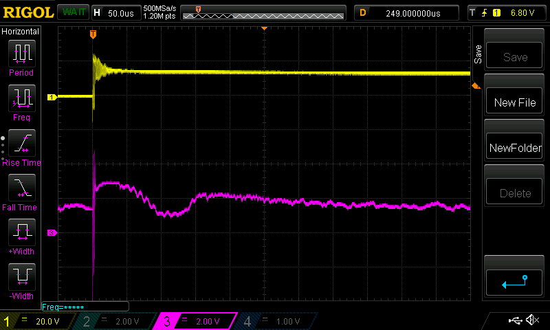

  • Hi Jacob,
    After you and your team kindly reviewed our schematics and layout and identified a grounding issue on CFLT and CINN, we've since modded our custom board to get around this and also made sure we removed the scope probe from the transducer. As you can see below, the signal has improved lots.
    I think this should be good enough for me to programmatically determine the TOF which is great!
    Thank you so much!
  • Hi Louis,
    Thanks for testing the ground changes for CFLT and CINN.
    It is great to see the drastic improvement in quality of the Vout signal. I expect this to be a detectable return echo for TOF measurements.
