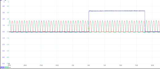

    As for the data that is different, do you see the same issue if you change the automatic amplitude correction back to enabled? If so, can you take an oscilloscope capture of the sensor oscillation in both cases to make sure the sensor is operating correctly.
    Justin Beigel
  • Hello Justin,
    I checked you suggestion. No matter whether automatic amplitude correction is on/off it does not influent sensor oscillation performance.
    here it is with automatic amplitude correction on:
    here it is with automatic amplitude correction off:
