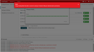

i just received my AWR6843AOPEVM i try to flash it with the out of box binairy bin, the uniflash software stops and tell me permission deneid
I checked the port number and flash mode configuration but it still doesn't work.

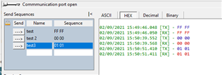

  • Hello Jitendra,
    I use docklight and send 0xFFFF ,0x0000 0x0101 and the board sends me the same thing

    I checked the COM port settings, power, restarted Uniflash 5 times, tried it on 3 different computers and I have the latest version of Uniflash.
    Q2: I tried Uniflash with Chrome and I have the same problem, it freezes when it tries to connect to COM port 14 and the sensor starts to heat up.

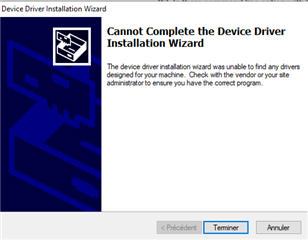

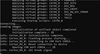

    Q7: I followed all the steps and generated the package for the standalone command line. I ran  dslite-Cortex_R4_0.bat after edited the command line
    and dpinst_64_eng.exe and got this message.

    • I am in flash mode and try to use the pre-built IWR6843, AWR6843 and AWR6843AOP and uniflash crashes again when it tries to communicate with the COM port.
      Power up
    • Connecting the USB UART and USB power seems dangerous to me but I followed your instructions.
      I used uniflash to generate the .bat again and it crashes again
    • I use the latest version for Silabs
    • I killed flashpythonsubprocess.exe, restarted uniflash, tried to flash again and it crashes again when it does not communicate with the COM port.
    • I tried with uniflash online and it crashes too
