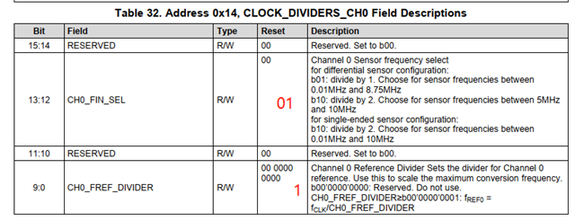

    4. Just to confirm: you are setting your ref divider to one, so your fref is 40MHz?

    CLOCK_DIVIDERS_CH0_REG = 0x2002;

    CLOCK_DIVIDERS_CH0_REG = 0x2001;
    CLOCK_DIVIDERS_CH1_REG = 0x2001;
