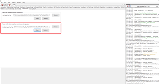

    I tried to use the 'phase shifter calib data restore configuration ' in 'CalibDataCfg' Tab in mmwave studio 2.1.1.0. Could you kindly help to check what is the format of the input file?
   I tried to click 'save' button, and this generate a file named 'PhaseShiftCalibData.txt' under 'C:\ti\mmwave_studio_02_01_01_00\mmWaveStudio\PostProc'. This file has 201 word32. I think there are 192 phase code values for there TX case. Why this file have 201 words?

    It stores the full structure data to the file, which contains the [txIndex, calibApply and 128 bytes of calibdata] * 3 chunks
    You can refer MMWL_savePhShiftCalibDataToFile function from mmwavelink_singleChip_example from mmWave DFP 2.2.x version

  • I hope customer needs to restore the phase shift calibration data at every device boot up where original phase shift calibration data is being captured in the controlled environment (room temp, corner reflector at zero angle, no clutter) and stored on flash.
     Please note that while restoring CAL_Apply needs to set '1' for the last chunk so FW can apply this phaseShift calib to HW.
    Please look for ‘Sub block 0x008C – AWR_PHASE_SHIFTER_CAL_DATA_RESTORE_SB’  in DFP 1.2.6 ICD for data format of calibration data.

       I also checked the ‘Sub block 0x008C – AWR_PHASE_SHIFTER_CAL_DATA_RESTORE_SB’  , the remaining question is about how to map the format in ‘Sub block 0x008C – AWR_PHASE_SHIFTER_CAL_DATA_RESTORE_SB’ to saved file ‘PhaseShiftCalibData.txt' in mmwave studio 2.1.1.0. Customer will test phase shifter calibration in mmwave studio firstly, and they need understand studio output file format to do the experiment.

    If customer is interested in AWR1843 and looking for phseShiftCalib store/restore APIs and need to implementation restore part, so they can either just store the calibration payload or the full structure of all three chunks to Flash to later read and restore to the device.
    PhaseShiftCalibData.txt from mmWave_DFP example stores the full structure for all the three chunks, attached is the csv file for explaination.
    7827.phaseShift_data_format.csv
    If you refer C:\ti\mmwave_sdk_03_05_00_04\packages\ti\control\mmwavelink\test\common\link_test.c:
    mmwaveLink_phShiftCalibDataStore
