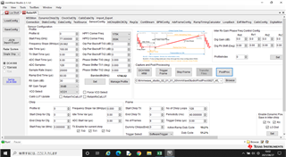

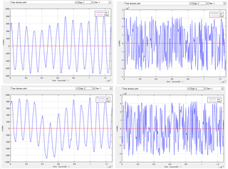

The result of the measurement with mmwave studio or the following result.
In this case, is it okay to recognize that chan2 and 4 fail in measurement and scatter?
Also, please tell me the reason for becoming chan2 and 4.

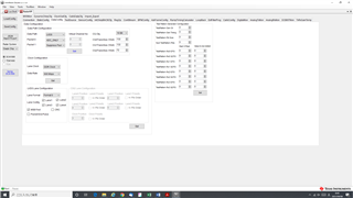

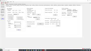

Can you please share the other configuration tabs: StaticConfig, DataConfig?
What object do you have in front of the sensor, what distance?
Could you use a corner reflector?
