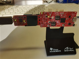

    This is true, the lab is only compatible with ES2.0 silicon of the IWR6843AOP. Can you post a picture of your powered board when this error occurs?
    AG

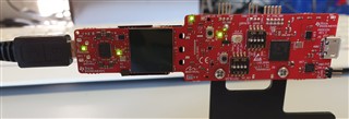

  • Hi Akash,
    Picture 1 is the chip, 2.1 and 2.2 is when I try to connect to the Visualizer and 3.1 and 3.2 is when I press the NRST button after connecting. I hope the resolution is sufficient.
    1:
    2.1:
    2.2:
    3.1:
    3.2:
    with best regards,
    Nikita

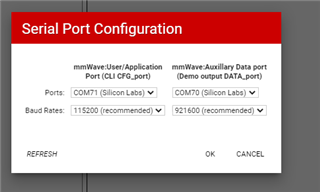

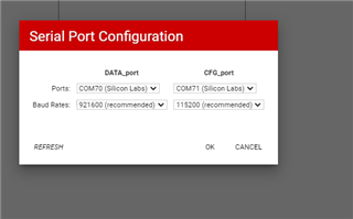

  • Hi Nikita
    Can you confirm you've selected the correct COM ports? Please note the order of DATA_port and CFG_port are reversed between the mmWave Demo Visualizer and High Accuracy Visualizer.
    High Accuracy Visualizer:
    mmWave Demo Visualizer:

  • Hi Akash,
    yes, I am confident that the selected ports are correct. To be sure I tried both options. If I put them in wrong order the same Message appears. To verfy I have attached two pictures of the COM Ports where I think that the correct COM ports are selected:
    However I found something interesting (I don't know if it is of interest to you): If I press the NRST button after I selected the COM Ports in the Visualizer and it is trying to connect regardless of which COM Ports I selected only the CFG Port connects (in both cases COM 5 or 4 selected as CFG).
    with best regards,
    Nikita

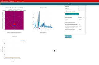

  • Hi Nikita
    I am sorry but I am not able to reproduce this error. It seems you are doing the proper steps so I cannot easily explain your error.
    These are the steps I have taken:
    • I have flashed my IWR6843AOPEVM with high_accuracy_68xx_demo.bin in the prebuilt_binaries folder from mmwave_industrial_toolbox_4_8_0
    • I am using the High Accuracy Visualizer 2.0.0 and connect by clicking the Options button and selecting the Serial Port ... button.
    • After clicking the LOAD CONFIG FROM PC AND SEND button in the visualizer I select the high_accuracy_demo_68xx.cfg file in the chirp_configs folder. I have attached it here as well.
    My visualizer is running as intended.
    AG
  • Hi Akash,
    it seems like there is a little inconsistency in the Visualizers: When I use the Demo Visualizer and select the Serial Ports and everything is allright it immediately says "Hardware Connected", after which I usualy load the config. However this doesn't seem to be the case with the high accuracy Visualizer. After I select the Serial Ports it says "Connecting 1 of 2" so I accutally never tried to load a config file, since I thought it already wasn't working. But if I load the Config File anyway it somehow connects and works. After that it also says " Hardware Connected". But like i said this wasn't clear to me. Thank you for your help and I would really appreciate if you could look into this so other people don't get confused like me :)
    with best regards,
    Nikita
