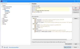

    On Code Composer Studio - Version: 10.3.0.00007, below are the steps to follow
    - first install the code gen tools as pointed above. make sure the install path is set to \ti\c6000_7.4.16
    - right click on the project sense_and_direct_68xx_dss and select "show build settings"
    - on the properties window, in the dropdown for compiler version select TI v7.4.16
    if "TI v7.4.16" version is not available do the following steps.
    - click the "More" button. On this window click "Add..." and select the folder where the tool is installed.
    The new compiler tool should appear in the "Discovered Tools" area. Apply the settings and repeat the steps to select the compiler tool. This should resolve the issue.
