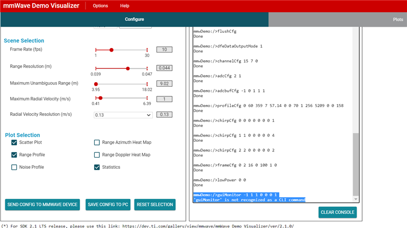

I am using IWR6843ISK-ODS sensor and try to make it work for people counting demo with mmWave_Demo_Visualizer to get a right configration file that I will use.
But still is show me an error when I sent the config file to the sensor as this ( mmwDemo:/>guiMonitor -1 1 1 0 0 0 1 'guiMonitor' is not recognized as a CLI command)
Thanks so much.
