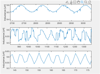

    Thanks for the response. The results I'm getting are very different depending on firmware version. In the figure below, the top one is the older firmware version and the second is the up to date one. Both were with the same configurations settings: single channel 0, internal oscillator, settle count 1024 and ref count 1024.The standard coil coming with the EVM was used. In the data streaming tab, the EVM output rate was used. This also seems to impact the data written to the .csv file, as the top and bottom figure had the same configuration settings, but the EVM output rate was used for the top one and the 50ms update rate for the bottom.
    Do you have a suggestion how I can check if the data given by the LDC1614 is same for both firmware version? The top figure is in line with my expectations, but I cannot imagine that the sensor measures something different based on the firmware. Perhaps I should not use the MSP uC to readout the data, but use an Arduino or something like that.

    I see that the units are in uH on the graphs, can you also compare the raw data codes from the device to better see if there is a difference in the data. This would remove the calculations that the GUI does. Also, it looks like there is some target movement in the data, if you were to take some samples without a target at all, does the data look the same?

    The data in the .csv file is sampled at the same rate for both uH and raw data, so there is no difference between the two. I expect that this has something to do with you the data is written into the .csv file.
    In the figure below you can see that there is a difference between the two firmware versions wrt logging the data. The target is not moving, so the orange data set is what I would expect. With the most recent version, I notice two things. The data logged in the  figure below is more jumpy, while there should be no reason for that. Another thing is that in the data streaming GUI the data is a lot more sluggish and totally not fluent wrt the older firmware version.

    I have also confirmed the delay in the data streaming GUI on my end but haven't found the cause for it yet. When connecting a Pi or Arduino, the I2C pullups are on the MSP portion of the board so if that is snapped off, you will have to make sure the pullups are handled by your external controller.
