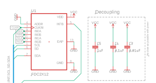

I am working on two pcb's, one of them with FDC2112 and one with FDC2212.
I have the same problem in both. I cannot change the Vpp of the channels using the IDRIVE registers.
I will attach photos of the schematic and pcb and the register settings that i am using.
The setting are:
Single channel operation, external 40MHz crystal, HIGH_CURRENT_DRV -> Disabled, SENSOR_ACTIVATE_SEL -> use idrive.
Channel 0 works in differential configuration with two plates (12.5cm x 10cm) attached to IN0A and IN0B respectively.

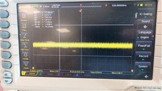

The board is powered through an esp32 voltage regulator which is a bit noisy. The power supply on the FDC2x12 power pin is at 3.3V with ~= 350mV noise.

    The circuit around the chip was designed in accordance with the EVM schematics so the only thing that comes to mind is that the chip's supply which is noisy, somehow affects the output current on the channels. The chip is supplied by the 3.3 pin on an Adafruit huzzah32 which contains a voltage regulator. I am attaching a snapshot of the oscilloscope from GND to FDC's V pin.
    • Vmax = 3.58 V
    • Vmin = 3.06 V
    • Vpp = 520 mV
    Do you think this could cause the problem? If so i could try a more steady supply in the next board revision.
    Vasileios

    Before waiting on a board rev, would it be possible to try a hack of the existing board?
    Can you cut the PCB VCC runner to the FDC2212 and supply the device with an external bench power supply?
    If that is possible, it might help settle the issue.
    If the hack isn't possible - or doesn't work - can you share your schematic and layouts?
    We can review them on our end and provide feedback.
    John
  • Hello John, the noise on the power supply was coming from the lipo battery.
    I run both the pcb and huzzah32 controller from a bench power supply @ 3.3V and verified noise <50mVpp on the Vpp of FDC2212.
    The problem persists. I cannot publicly share schematics and layout but I will ask for permission to send them in a personal message if this is acceptable from your side.
