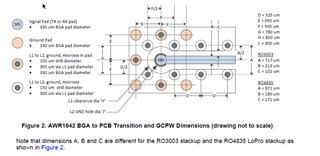

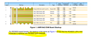

We are into a designing a high-gain radar board based on AWR1843Boost with RO3003G2. We noted that the RO3003 values in the attached picture have been calculated for 4MIL 3003 (213um is for 4MIL) which Rogers does not supply; both RO3003 and 3003G2 substrates offered are 5MIL. We can calculate the B dimension below, would you help us with the A and C dimensions based on 5MIL RO3003 please?
