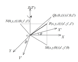

The actual Angle of the sensor is not facing straight forward, but turned θ degrees horizontally. But I need the output coordinates are unturned.
It works like this:
How to modify the program in MRR, change the Angle of the point.
Thank you

    This is a 3D coordinate system transformation. You would have to read up on the math, but in general, a 3D transformation would be a simple matrix-vector multiplication.
    Once you have the math figured out, you can make modifications in dss/dss_data_path.c file to apply the transformation to the XYZ output.
