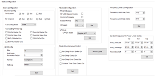

I am trying to configure the MMWCAS-RF-EVM (AWR2243) along with the MMWCAS-DSP-EVM. I have followed all the instructions from the mmWave Studio Cascade user guide till the capturing data portion of the guide. When I click Trigger Frame, I am hit with a RESP timeout error (line 176) The framing status does not update to "WAITING FOR TRIGGER' at all.
I am new to this TI system and your help would be much appreciated.
The logs can be found below:

[17:28:22]  [RadarAPI]: ar1.ChanNAdcConfig_mult(14, 1, 1, 0, 1, 1, 1, 1, 2, 1, 0, 2)
[17:28:22]  [RadarAPI]: Status: Passed

    Here is my Static Config Page:
    I've followed all the steps in the Guide (shown in the figure below)

  • Hi I would like to point out that the GUI guide doesn't work, however when following the LUA scripts. It does seem to be able to capture data!. Hence for anyone that is reading this, please use the LUA scripts instead of the GUI guide. Thanks!
  • Hello Gabriel,
    Thank you for highlighting your observations in detail. This definitely helps us to specifically point out where the configuration went wrong.
    From your log, I can see that you haven't configured the profiles, chirps or frames (and data config as well) for slave devices and hence that is why you're getting the error after "TDA ARM".
    This highlighted "1" denotes that only "Master" device was selected for configurations. Please note, you've to do similar configurations for ALL the devices and not just the master. You can do this by selecting the slave checkboxes on the left (as shown below):
    Also, If you look at the cascade user guide (page 17), the frame configuration requires a hardware trigger selection for slaves and software trigger for master.
    Please do this separately for master and slave devices.
    Only when all your configuration is correct, the device will be able to capture data successfully.
    The lua script works for you because it takes care of all this configuration in sequence already. The lua script is just an automated version of mmWave Studio GUI which helps skips this manual configuration.
    Hope this helps. Please let us know if you need any clarification.
    Ishita
  • Hi Ishita,
    Thanks so much for your help,
    Yes, once I did the configuration for the slaves it works perfectly. THANKS!
