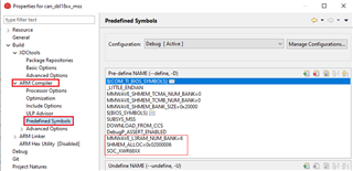

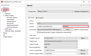

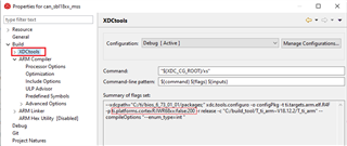

we have ported our CAN Secondary Bootloader (SBL) from AWR1843 to AWR6843. The following were adapted in the existing AWR1843 CCS project and related xwr68xxx files were included for the SW build.
Environment details:
Code Composer Studio - Version: 9.3.0.00012
MMWAVE SDK: 3.2.0.4
CCS Project Properties
I have also compared the environment settings in the TI sdk \ packages \ ti \ utils \ sbl \ and \ packages \ ti \ common \ and don't see any other differences other than the MMWAVE_L3RAM_NUM_BANK, SHMEM_ALLOC and SOC_XWR68XX.

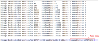

    I did debug further into the SBL Image Parser function and could observe that the SW stops in the SBL_readRPRCSecContent() function at the first memcpy call. Please see the "Debug: SBL_readRPRCSecContent 3 ..." statements.
    In the last print, the sectionPtr (section current address) jumped to 0x4000 0000. I have attached the section address prints from the start of the parsing and also the errorStatus value.
    Any idea what the gSblMCB.errorStatus value 4000 0000 means? I could not find it in the sbl.error.h file.

    Debug: SBL_readRPRCSecContent 3 1073741824 134346416
    Aghil
