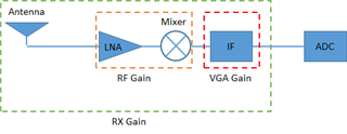

First, from the forum you asked to refer to, is it correct to think of the RX chain as the format shown in Figure 1 below?
Second, is it safe to assume that the RF gain target is set assuming the dB reflected from the object?
(Example: Set RF Gain Target to 30 dB when the dB reflected from the object is likely to be 28 dB)
Fig1. RX Chain
First: Yes
Second: RF Gain is set as high as possible even if dB reflected from object is lower

Yes, RF Gain Target changes the gain of the RF part of RX Gain
RF Gain should be as high as possible as long as there is no saturation

I was finally able to talk with the design team about this. I think I have communicated some information which was not correct in the past.
So, please read this
Here is the input from design team:
The RF Gain target is used to configure the LNA programming to achieve RX Gain = RF Gain Target w/ IF gain = 0dB. The reach the programmed RX gain then, the IFA gain is adjusted. So with regards to the example:
RX gain = 24dB
RF Gain Target = 30dB
This means the gain calibration will configure the LNA gain such that the RX gain = 30dB when IFA gain = 0dB. Then, to reach the overall RX gain programmed by the user, the IFA will be configured to its -6dB gain setting (i.e. RF gain target (30dB) + IFA Gain (-6dB) = RX Gain (24dB))
