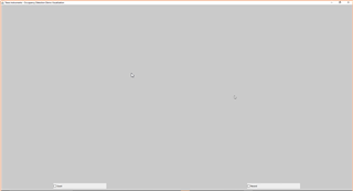

I am trying to run the vehicle occupant detection demo, but when I run the matlab exe from the command line, nothing populates the heat map or car demo. Is there anything extra I need to do to my eval board?

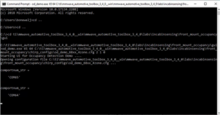

    3. Yes, the customer has followed the steps in the manual and said that he has flashed the device and switches are primarily set to zero and a bunch are labeled not applicable.
    Console of customer...
    GUI is blank...

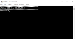

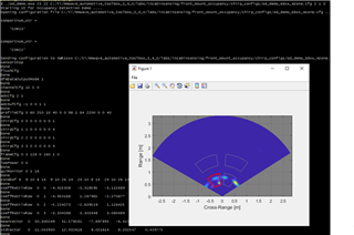

    3. I ran this demo on my local system using a 6843AOP EVM and used matching cli commands and had no issues running the demo (screenshot below). I would recommend they go through the steps again to be sure everything is configured properly. One thing they can test is that if they can connect to the application com port with baud rate 115200, do they see the message appear that states what demo they are running? I will include a screenshot below.
