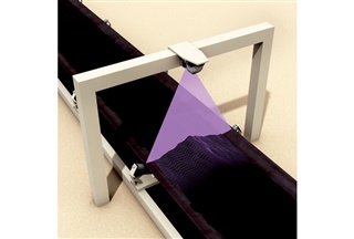

    Besides measuring the surface profile, I have two more applications that I have to implement:
    1. Measure the distance of a static object, aligned with the sensor, over 200 meters away.
    2. Measure the surface profile of soybean being carried over a belt conveyor to calculate the volumetric flow rate (m³/second or per hour), which implies the need of also measure the belt conveyor speed. The measurement distance is this case is of just few meters. See an example in the image below:
    I would like to implement a radar sensor to solve all these requirements (i.e., soybean surface profile in a tank, soybean surface profile in a belt conveyor, speed of the belt conveyor and distance of a static object). Maybe even the same some for all three requisites! Is that possible?
    Do you think that IWR1443 would fit the above applications as well? What about the TIDEP-01012 cascade module, I found the examples from the design guide interesting. Does it enable more accuracy in the measurements?

  • Hi Junior
    1. 200 meters will be too far for mmWave sensors to detect. Limit is about 100-120 meters.
    2. mmWave sensors are very good at measuring velocity, so I think it would be suitable for this application.
    Lastly, this depends what kind of measurement accuracy you are looking to get in the sand/bean silo with regard to angular resolution. if you need some but not very fine angular resolution then IWR1443 should be fine. However if you need very fine angular resolution then you will want to look into using the Cascade EVM. If you have questions on the Cascade EVM please submit a new thread with part number TIDEP-01012 or MMWCAS-RF-EVM.
