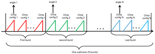

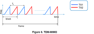

For the TXBF mode, for a burst-based beam steering frame structure, the 4D matrix is no samples per chirp x no chirp repetitions per loop x no of receivers (RXs) x no of steering angles. For the TDM MIMO mode, the 4D matrix is no samples per chirp x no chirp loops x no of receivers (RXs) x no of transmitters (TXs).

A) Duty cycle: In the TXBF mode, in the chirpprofile_TXBF_USRR.m MATLAB script, line 75, what does the variable params.Dutycycle represent?
  1. Does it account for the OFF duration before and after the chirp ADC sampling time? or does it account for the OFF duration between bursts (Frame-based beam-steering) or loops (chirp-based beam-steering)? or there is another definition?
  2. Does the duty cycle follow the same definition in the TDM MIMO mode? or is it defined differently in the TDM mode? What is its definition in the TDM MIMO mode?

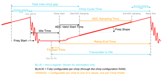

    In Cascade_configuration_MIMO.lua, "Inter_Frame_Interval" is used to initialize the Frame Period. The Frame Period has to be such that there is sufficient time for two things to happen before the next frame starts
          1) There is sufficient time for chirping (this is also called "Active Time")
          2) There is sufficient time to process the data after chirping is complete.

    Q1) Is the first interval, the "Frame Active Time" interval, formulated in the TDM MIMO mode as follows?
    let's define the "Chirp Time Interval" as follows. Chirp Time Interval = Chirp TX Idle Time + Chirp Ramp End Time
    Therefore, is the following formulation correct?
    Frame Active TimeChirp Time Interval x No. Chirps per Block (Number of Transmitters) x No. Blocks?
    Q2) How can I calculate/formulate the second interval in the Frame Period, the sufficient time to process the data after chirping is complete?
    Q3) In the TXBF mode, in the chirpprofile_TXBF_USRR.m MATLAB script, line 75, what does the variable "params.Dutycycle" represent?
    Does it represent the non-active duration around the chirp ADC sampling time (the "Chirp Active Time")? or does it represent the non-active duration between bursts (Frame-based beam-steering)? or there is another definition?
    Q4) Does the duty cycle in the TXBF mode follow the same definition in the TDM MIMO mode? or is it defined differently in the TDM MIMO mode? If yes, what is its definition in the TDM MIMO mode?

  • Q1 - Yes this is correct
    Q2 - The Processing time depends on how long the processing takes after 1D FFT is complete. You would need to benchmark the processing time to estimate it
    Q3 - Yes, params.Dutycycle is used to compute the burst periodicity
    Q4 - For TDM MIMO the burst periodicity is defined in a different way. It is defined in the JsonParser.m
