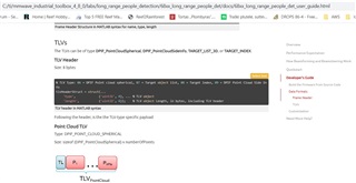

- TLV header length -> comment states that it include header size (% TLV object Length, in bytes, including TLV header). But my tests says, that cannot be true. Numbers what I read, says that length is only for TLV object. Can it be somehow verified?

  • I checked, and I believe there is a bug
    /* Side info */
    tl[tlvIdx].type = 9;//MMWDEMO_OUTPUT_MSG_DETECTED_POINTS_SIDE_INFO;
    tl[tlvIdx].length = sizeof(DPIF_PointCloudSideInfo) * result->numObjOut;
    packetLen += sizeof(MmwDemo_output_message_tl) + tl[tlvIdx].length;
    outputMessage.numTLVs += 1;
    tlvIdx++;
    Should be
    tl[tlvIdx].length = sizeof(DPIF_PointCloudSideInfo) * result->numObjOut + sizeof(MmwDemo_output_message_tl);
    packetLen += tl[tlvIdx].length;
    Then length includes header length as defined in docs.
    This is not a bug. The structure of the code that you highlighted is to build the type and length of each TLV. Additionally, the total length of the frame minus the header is kept track of in a variable called packetLen. Then once all of the TLV information is built the header is sent followed by the TLVs. Please see lines 1734-1735 in ITB 4.8. to see how this is done. packetLen is to keep track of the packet payload non inclusive of the header itself. The size of the header is fixed, no reason to keep track of its length.
    Connor Desmond
  • You right about paketLen, problem is with tl[tlvdx].length. According documentation, it should include header size as well and now it is not including it. You can fix documentation, but it would be nice if all products are consistent.
    For example, 3D people counting is including header size.
    The link you provided above is for the people counting demo which has a frame header length of 48 where as the long range people counting demo has a frame header of length 52. These are two completely different demos.
    \mmwave_industrial_toolbox_4_8_0\labs\people_counting\docs\3D_people_counting_demo_implementation_guide.pdf
    According to the following user guide:
    <MMWAVE_INDUSTRIAL_TOOLBOX_INSTALL_PATH>/labs/long_range_people_detection/68xx_long_range_people_det/docs/68xx_long_range_people_det_user_guide.html
    As can seen above the user guide and code match, thus there is no issue. You were using a different demos definition of size and applying it to this demo which is not correct according to the documentation. Now if you want to modify it for a particular reason then you can. You will just need to have parser which takes that difference into account.
