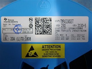

Our customer purchased these from franchised channel. The parts came in 13inch reels. According to public info, this should be placed on 7inch reels.
Are the reels used inter-changeably at TI?
Please check if there was a mistake at the factory level in packing or if there's a PCN to share.
Attached are pictures for your references.
Thank you.
/resized-image/__size/320x240/__key/communityserver-discussions-components-files/1023/TMP432ADGST-_2D00_-1.JPG
/resized-image/__size/320x240/__key/communityserver-discussions-components-files/1023/TMP432ADGST-_2D00_-2.JPG
  • Hi Shawn,
    Most devices are sold in two reel sizes denoted by the last letter. The datasheet does show that TMP432ADGST comes in a 13" reel despite the low (250 vs 2500) quantity. I've also checked internally and confirmed our records show this part number is sold on 13" reel.
