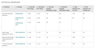

    Below is a snippet from the following webpage:
    https://www.ti.com/sensors/mmwave-radar/industrial/applications/applications.html
    Here you can see that IWR6843AOP the angular resolution is approximately 30 degrees in both azimuth and elevation. This is the main factor is which going to limit for mapping based applications. Since your application is for 3D mapping then this device gives the best angular resolution for both azimuth and elevation combined. Could you please provide an example of the point cloud that you are seeing, so that we could take a look?
