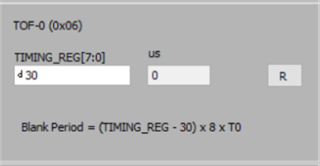

  • Hi Gerald,
    Thank you for relaying this information.
    There are a few things to note by looking at the configuration. Firstly, there is no blanking period being used at the moment. This is very important as a monostatic TOF measurement could trigger the threshold from the ring down of the transducer.  See below for example (the width of time segments does not necessarily correlate with the actual time used).
    Does the customer have an idea for the estimated TOF in their application? If not, could you help me understand what the minimum and maximum water levels are for detection? This will help me suggest some alternative device settings to improve the sensing application.
    Additionally, how is the customer mounting the transducer? In the case of a 1MHz transducer, I recommend mounting the transducer to the bottom of a fluid tank similar to the below diagram.
    This document details the best method for ensuring a proper mount between the transducer and the tank: SNAA266a.
    Once I know the details for the water level ranges, I can make more suggestions as for what settings to adjust.
