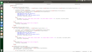

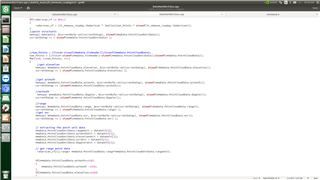

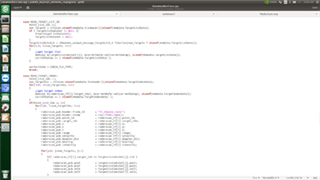

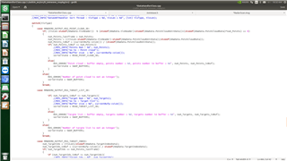

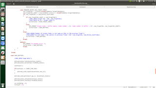

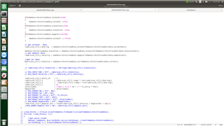

  •  switch(tlvType)
                        case MMWDEMO_OUTPUT_MSG_POINT_CLOUD_3D:
                            if( (tlvLen) % (sizeof(mmwData.tlvHeader)+sizeof(mmwData.PointCloudUnitData))+(sizeof(mmwData.PointCloudData)*num_Points) == 0)
                                num_Points_lastframe = num_Points;
                                num_Points = ((tlvLen-sizeof(mmwData.PointCloudUnitData))/sizeof(mmwData.PointCloudData));
                                num_Points_inBuf = (currentBufp->size()) / (sizeof(mmwData.PointCloudUnitData));
                                if( num_Points_inBuf >= num_Points){
                                    //ROS_INFO("Points Num : %d", num_Points);
                                    //ROS_INFO("Go to : Point cloud");
                                    //ROS_INFO("Buffer size  = %d", currentBufp->size());
                                    sorterState = READ_POINT_CLOUD_3D;
                                else{
                                    ROS_ERROR("Point cloud : buffer empty, points number = %d, points number in buffer = %d", num_Points, num_Points_inBuf);
                                    sorterState = SWAP_BUFFERS;
                            else{
                                ROS_ERROR("Number of point cloud is not an integer");
                            break;
                        case MMWDEMO_OUTPUT_MSG_TARGET_LIST_3D:
                            if( (tlvLen)  % sizeof(mmwData.TargetListData) == 0)
                                num_Targets = (tlvLen)/sizeof(mmwData.TargetListData);
                                num_Targets_inBuf = (currentBufp->size()) / sizeof(mmwData.TargetListData);
                                if( num_Targets_inBuf >= num_Targets){
                                    //ROS_INFO("Target Num : %d", num_Targets);
                                    //ROS_INFO("Go to : Target list");
                                    sorterState = READ_TARGET_LIST_3D;
                                else{
                                    ROS_ERROR("Targte list : buffer empty, targets number = %d, targets number in buffer = %d", num_Targets, num_Targets_inBuf);
                            else{
                                ROS_ERROR("Number of targte list is not an integer");
                            break;
                        case MMWDEMO_OUTPUT_MSG_TARGET_INDEX:
                            num_TargetIdx = (tlvLen)/sizeof(mmwData.TargetIndexData);
                            num_TargetIdx_inBuf = (currentBufp->size()) / sizeof(mmwData.TargetIndexData);
                            if( num_TargetIdx == num_Points_lastframe)
                                if (num_TargetIdx_inBuf >= num_TargetIdx){
                                    //ROS_INFO("Target Idx : %d", num_TargetIdx);
                                    //ROS_INFO("Go to : Target index");
                                    sorterState = READ_TARGET_INDEX;
                                else{
                                    ROS_ERROR("Target index : buffer empty, index number = %d, index number in buffer = %d", num_TargetIdx, num_TargetIdx_inBuf);
                            else{
                                //ROS_ERROR("Number of targte index is not same as that in the previous frame");
                                //ROS_WARN("Current index = %d, points in previous frame = %d", num_TargetIdx, num_Points_lastframe);
                            break;
                        default
                            ROS_ERROR("TLV header error.");
                            break;
    after editing the code to the above
    the tlv error disappeared
    but it is still yet to publish the data
