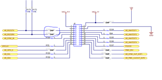

I am trying to use the 20-Pin Booster pack connections at the backside of the IWR1843Boost device to pass the UART MSS LOGGER Data to another device. But somehow, I do not find any mux control switch settings on the card.
Also, my UART data is always getting routed to the USB connector. Kindly help me in finding the setting to switch the UART to the booster pack connections to pass UART data to a launchpad.
I feel there are some hardware settings required.
