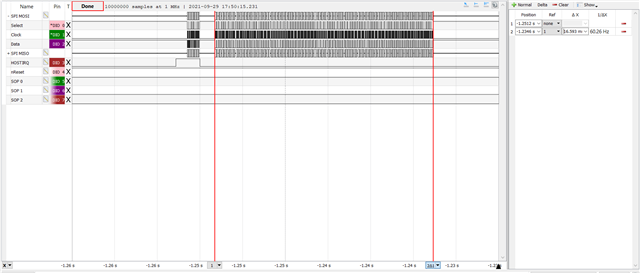

I am able to get to step 7 where HOSTIRQ is brought low and my host device begins reading the message from the AWR. Here is a wave form capture of just that:
This string of message on MISO goes on for roughly 16 ms, shown here:

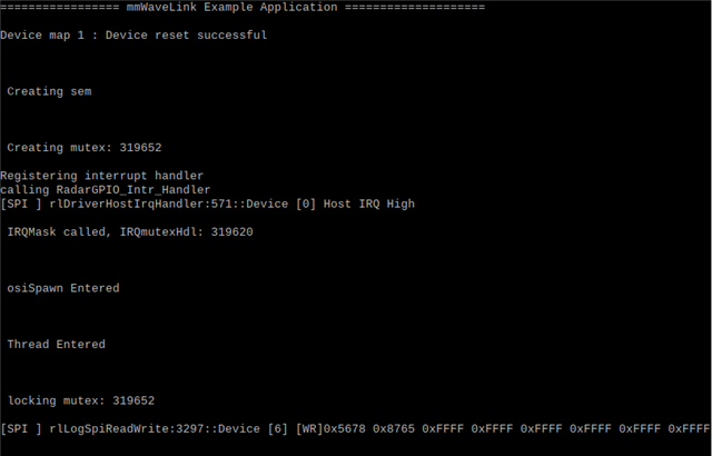

For completeness here is my terminal window after executing the application:
    Looks like somehow this if condition doesn't match which later causes [  else if (count >= (rlUInt16_t)RL_SYNC_SCAN_THRESHOLD)  ] condition true.

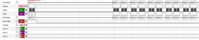

    Here is working received data at this point (first asynchronous event message) for your reference-
    # INFO: Received HOST_IRQ_LOW command from device 1
    Device [1] [RD]0xDCBA 0xABCD
    Device [1] [RD]0xA036 0x0026 0x000C 0x0000 0x0001 0x5F96
    Device [1] [RD]0x5000 0x0018 0x774A 0x0015 0x0040 0x0000 0x0000 0x0000 0x0000 0x0000 0x0000 0x0000
    Device [1] [RD]0xCD8B

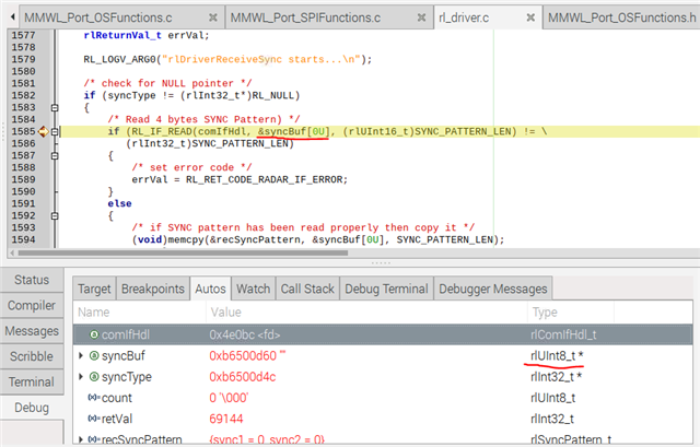

    So it appears the variable syncBuf that the driver is using in the RL_IF_READ call is a pointer as opposed to a buffer of data like cynsBuf, here is a screen grab of my finding:
    The usage of syncBuf and its type are underlined in red.
    It appears the driver is using the address of syncBuf(so a pointer to a pointer) in the buff parameter of RL_IF_READ.
    Can I get more clarification on what is going on here?
  • syncBuf is an array, and mmWaveLink passes pointer of 1st index of this array to RL_IF_READ function. RL_IF_READ is nothing but rlComIfRead callback which you have implemented in the application to read the data from SPI interface.
    Now you need to check implementation of this callback, where you need to update this memory region (array pointer) with the read SPI data.
    Looks like in the callback function data is not properly update, that is the reason that on the SPI line data is available but somehow it is not reaching to mmwavelink layer (rl_driver.c).

  • Looks like each 8bits are swapped here by your Host SPI interface.
    Please check in your SPI driver for how data copy is set while it receives from external line to internal FIFO/RAM
    MSB or LSB first, any swap setting applied there.
    what is SPI data format x data word length? it should be 16 bits not 8 bits.
    On physical line data is correct 0xABCD and 0xDCBA but while Host SPI interface copies those to application RAM, each 8bits are swapped. Please check your SPI driver in detail.
